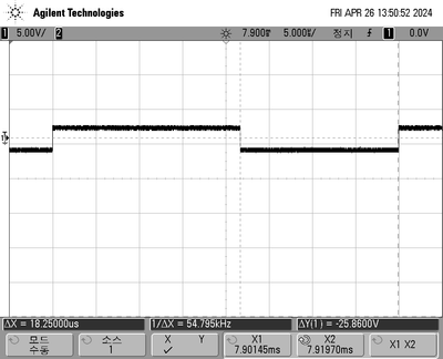

I'm using STM32H735VGT and ADC3.
There is too much time difference between converting 2 channels and 3 channels.
I want to know why converting 3 channels suddenly takes a lot of time.
And I want to know how to fix it.
Here are the scope photos and codes in each situation.
ADC3 , 2ch

ADC3 , 3ch
static void MX_ADC3_Init(void)

And, Is there any fast channel??
