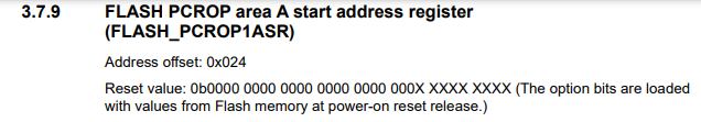

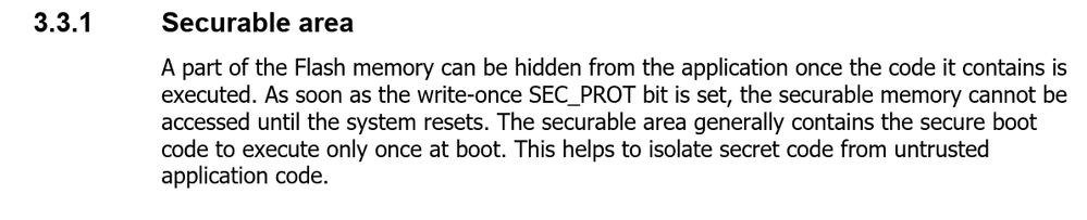

AScha.3
October 21, 2022
  • if not in Cube - not in chip. (most likely)
seems the "protection unit" is here, but a very simple level:
0693W00000UoY7LQAV.png0693W00000UoY7aQAF.pngso there is no special "MPU-unit" to activate in Cube, just some registers for flash protection:
