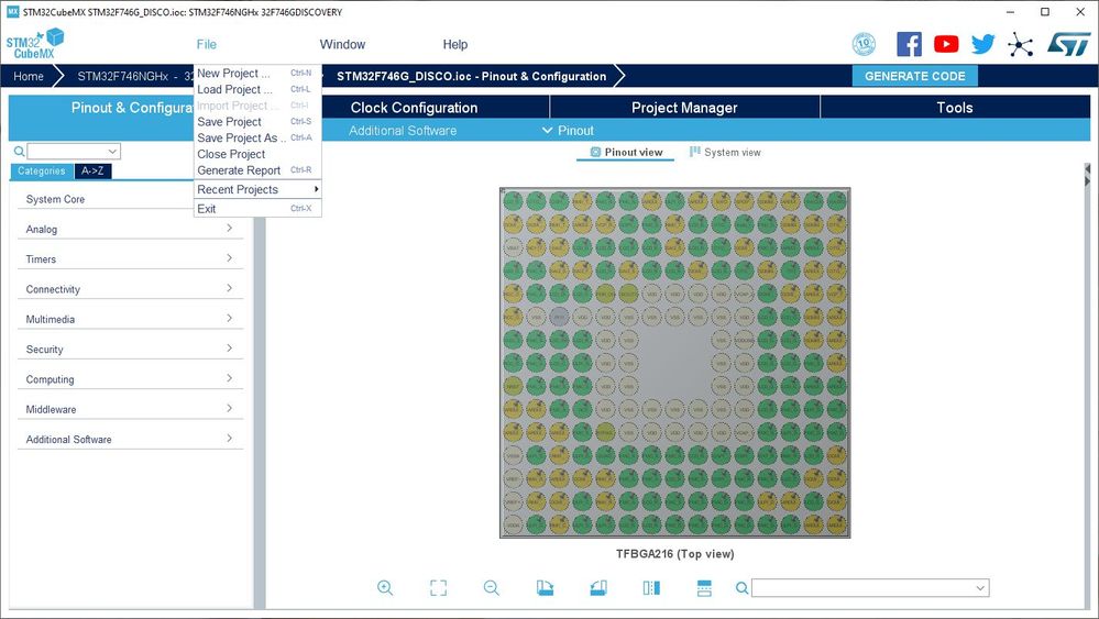

I'm using 5.5.0 and want to import a 5.4.0 project but the Import Project is grayed out. This is a fresh install
If a reply has proven helpful, click on Accept as Solution so that it'll show at top of the post.
CAN Jammer an open source CAN bus hacking tool
CANableV3 Open Source
Nawres GHARBI
Hello @Community member​
Import do work only on a fresh loaded MCU, importing on a configured MCU (like in the screenshot) will be available in a future release of MX

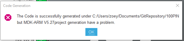

I firstly removed the 5.5.0 which was installed via update tools and then install 5.5.0. However, it still failed to generate the project.0690X00000D9kegQAB.png

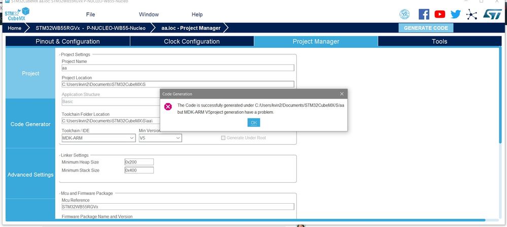

I guess you are using Java13. If yes, please remove this version and install at least Java11 or Java8. We found an issue with Java13/Keil IDE, this issue is not related to STM32CubeMX upgrade process.
For info: STM32CubeMX is not yet validated/tested with Java13.
The new 5.6.0 with Java 8 still has the same error.​
