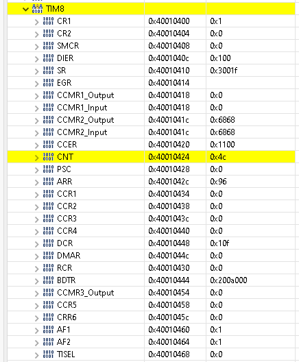

If you set CCR3 and CCR4 in the setup code to some "random" values, do they remain or do they change to 0?
Read out and check/post content of TIM, DMA, DMAMUX registers.
Note, that reading TIM registers in debugger influences the "burst" mechanism (it messes up the internal "current register pointer", but it still should work somehow, though).

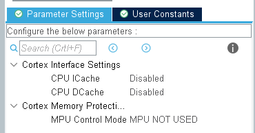

The cache is disabled (I figure it would save some troubles):

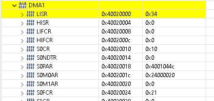

My DMA settings:
0693W00000GYg2aQAD.pngThere is no transfer error, just the DMEIF0 which is described to be set "when a DMA request occurs when the previous data has not yet been fully transferred", which is odd because there is nothing else running or using the memory bus.

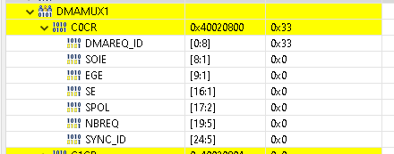

Here are the timer and DMAMUX settings
waclawek.jan
Both S0CR=0x10 and S0NDTR=0 are wrong.
Where do you set the DMA control registers fields?
Hi Jan,
Those registers were initialized from CubeMx, but I was still palying with the values, The correct settings, as described with half word and no buffers are
S0CR = 0x22C50
Anyway I've solved it, it's related to the order of which the init is done from CubeIDE
Tim8 Init contains some DMA settings that are performed before the clock is activated for the DMA init:
  /* TIM1_UP Init */
  LL_DMA_SetPeriphRequest(DMA1, LL_DMA_STREAM_0, LL_DMAMUX1_REQ_TIM1_UP);
  LL_DMA_SetDataTransferDirection(DMA1, LL_DMA_STREAM_0, LL_DMA_DIRECTION_MEMORY_TO_PERIPH);
  LL_DMA_SetStreamPriorityLevel(DMA1, LL_DMA_STREAM_0, LL_DMA_PRIORITY_HIGH);
However these are executed before enabling the clock for the DMA:
static void MX_DMA_Init(void)
  /* Init with LL driver */
  /* DMA controller clock enable */
  LL_AHB1_GRP1_EnableClock(LL_AHB1_GRP1_PERIPH_DMA1);
Calling the MX_DMA_Init before anything else will do the trick:
  /* USER CODE BEGIN SysInit */
  MX_DMA_Init();   //Added
  /* USER CODE END SysInit */
  MX_GPIO_Init();
  MX_TIM8_Init();
  MX_DMA_Init();
I believe that all the values were correct, but without clock during the set-up, something inside the MCU was not getting initialized properly.
Thank you for the support,
Marco
