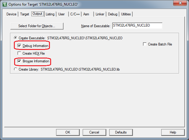

I am using KEIL MDK 5 and it is compiling very very slow.
CubeMX  v4.24
STM32CubeF4 v4.19.
Any ideas  ??
Thanks
Sasha

Hello Sasha,
Compilation time in Keil MDK-ARM IDE can be significantly reduced by changing project's options: please
uncheck
 ''Debug Information'' and ''Browse Information'' in ''Output'' tab of project's options. Below I attach picture with these two options highlighted.0690X00000609WeQAI.png
Regards
Szymon

Posted on January 29, 2018 at 23:23
Hello Szymon,
This is not good solution. How am i suppose to find definitions now?? if this is the only solution than i cant use KEIL anymore.
This problem is new and it has began after upgrading to new versions. Before that everything was OK.
I think the problem is within the STM32F4CUBE  drivers. ST changed something inside and caused the problem.
Sasha
Posted on January 30, 2018 at 07:31
Many thanks Szymon for the suggestion. In my case a got the following results:
Tested the 'Rebuild' with checked and unchecked 'Browser Information':
-CubeMX v4.23 generated skeleton + 300 lines o custom code: 40s / 6s
-then migrated the project to CubeMX v4.24: 65s / 6s
In both cases I gained a lot for Rebuild process.

Posted on January 30, 2018 at 09:00
But you cant use the 'go to definition' option without the Browse information checked.
Posted on January 30, 2018 at 09:40
True. Just tested the performance.
Posted on January 30, 2018 at 09:52
Hello Sasha,
I confirm, that unchcking each of options, which I mentioned, introduces a drawback or limitation.
When you uncheck 'Debug Information', durign debug session you will experience problems with debugging.
When you uncheck 'Browse Information', you will experience problems with navigating in the source code.
But having in mind these two options you can decide to switch them on or off depending on the situation if you need them or not.
