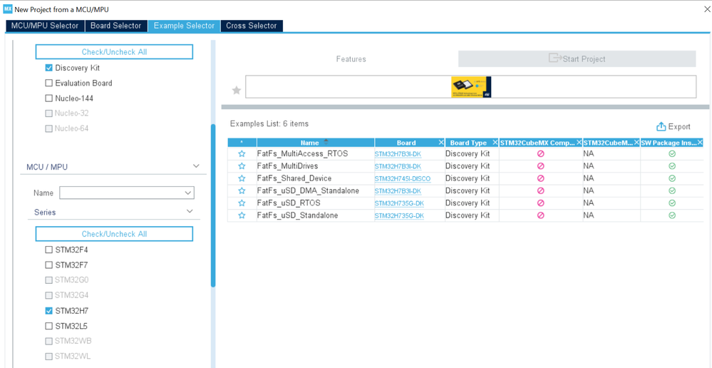

Example selector allows you also to browse a large set of examples and to start a new project from a selected example:

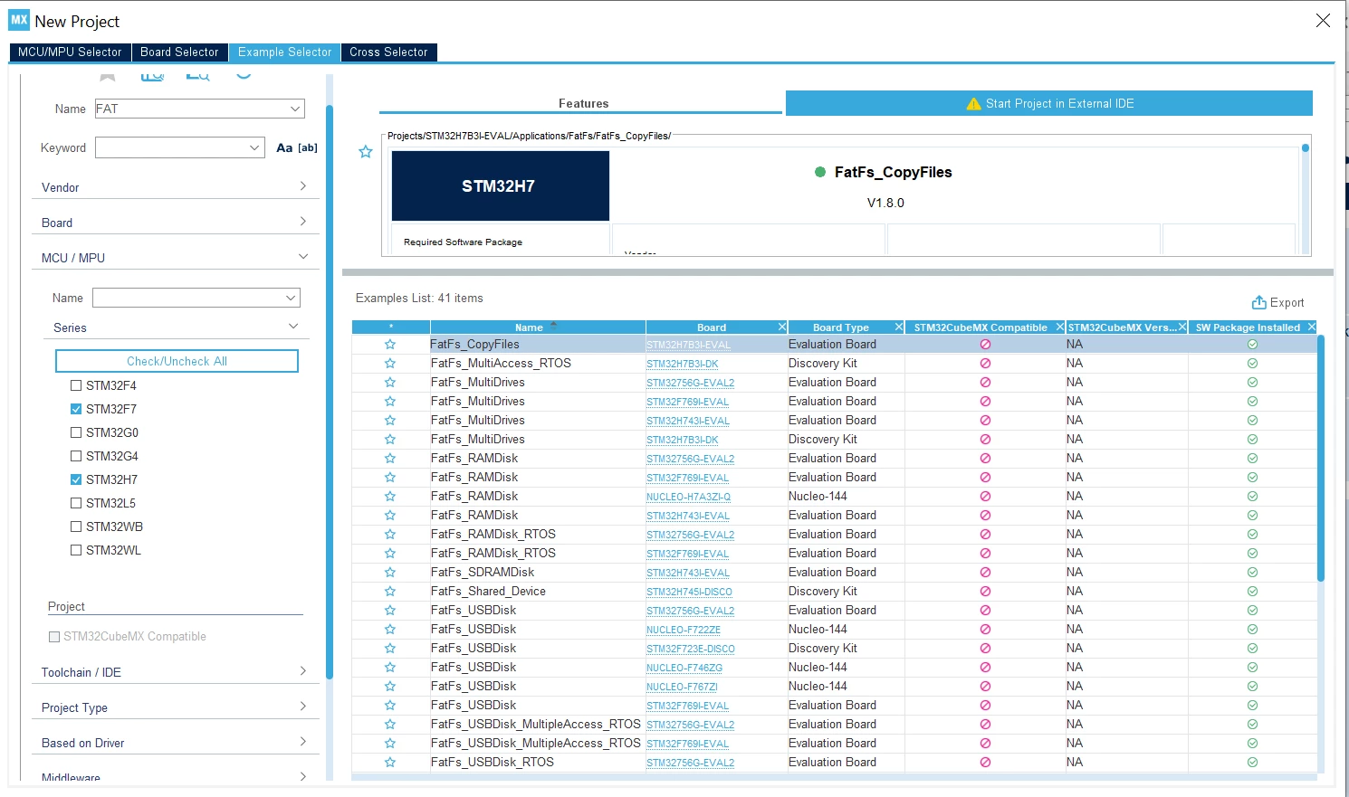

As I indicated above, through the Example selector, you can browse a large set of examples and thanks to the filter panel it is possible to filter down the example list:

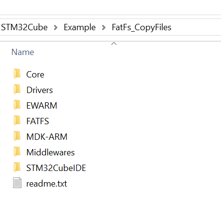

Taking FatFs_CopyFiles project for example: Which is an application describing how to use STM32Cube firmware with FatFs middleware component as a generic
FAT file system module. This example develops an application that exploits FatFs features to configure two microSD drives and copy files from the first instance to the second.
Opening the project folder :
0693W000007E1kkQAC.pngIn the generated app_fatfs.c file, you'll find this code snippet:

Backing to examples in the STM32Cube MCU Package examples for STM32H7 Serie Application Note, FatFs_USBDisk_Standalone example may be a good
start point to develop your application: This application describes how to use STM32Cube firmware with FatFs middleware component as a generic FAT file system module and STM32 USB On-The-Go (OTG) host library, in Fullspeed (FS) and High-speed (HS) modes, to develop an application exploiting FatFs offered features with USB disk drive configuration.
Starting from this project, you can modify it in order to get .wav audio data from USB Flash Disk.

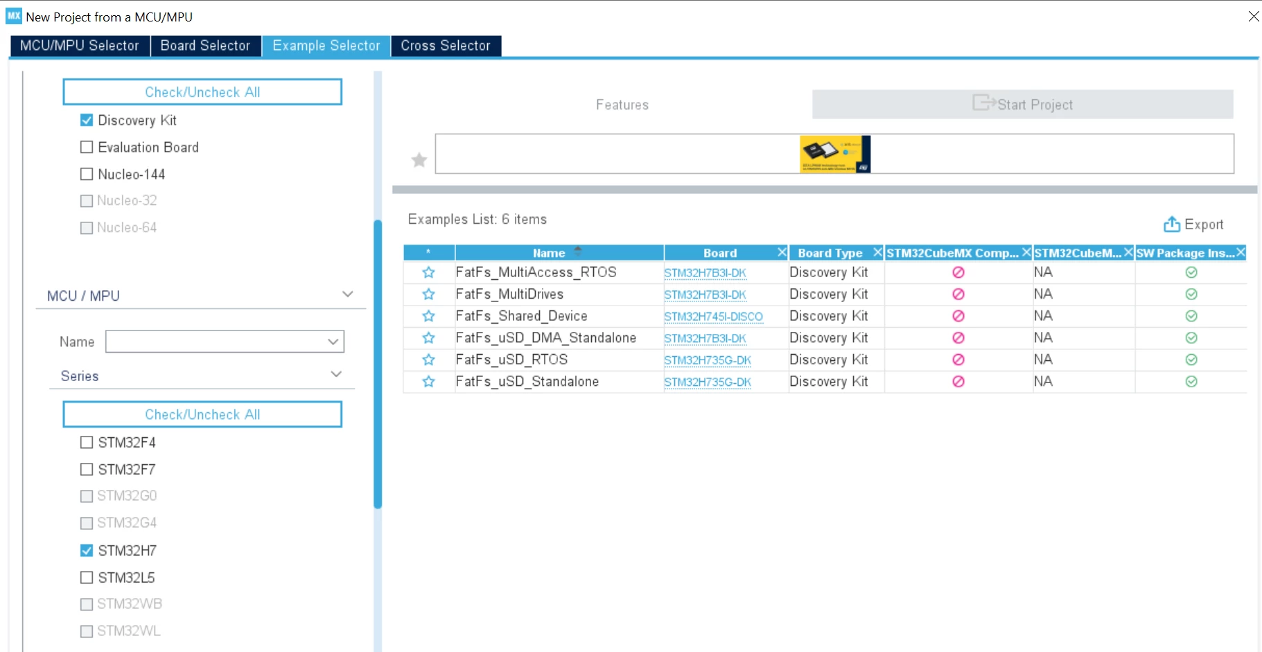

Would the FatFs_uSD_Standalone example allow me to load files via uSD card port?. This runs on the cheaper STM32H735G-DK board so would be better.

The FatFs_uSD_Standalone example develops an application that exploits FatFs features to configure a microSD drive.
The application is based on writing and reading back a text file from a drive, and it's performed using FatFs APIs to access the FAT volume as described in the following steps:
  • Link the uSD disk I/O driver;
  • Register the file system object (mount) to the FatFs module for the uSD drive;
  • Create a FAT file system (format) on the uSD drive;
  • Create and Open new text file object with write access;
  • Write data to the text file;
  • Close the open text file;
  • Open text file object with read access;
  • Read back data from the text file;
  • Check on read data from text file;
  • Unlink the uSD disk I/O driver.
You'll find more details about this application under <...\STM32Cube_FW_H7_V1.8.0\Projects\STM32H735G-DK\Applications\FatFs\FatFs_uSD_Standalone\readme.txt >
