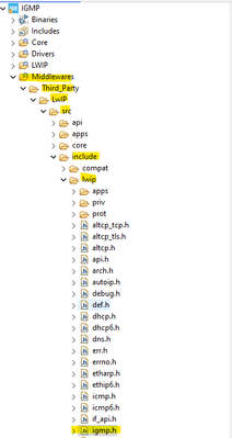

Hi
I try to use IP multicast function. With 6.13, i enable IGMP, and then generate code, but it seems there is no any files added(such igmp.h), these files are necessary for multicast.
Could you check this IGMP feature?  I have thought it's basic feature.
Thanks
Peter
1 reply
KDJEM.1
May 8, 2025
Hello @Peter3718;
First of all, I apologize for my late reply.
Do you mean that you can't see the igmp.h file in middlewares?
The igmp.h file is generated when using STM32CubeMx6.14.1 as shown in the below figure.
Could you please try with the latest STM32CubeMx version?
Thank you.
