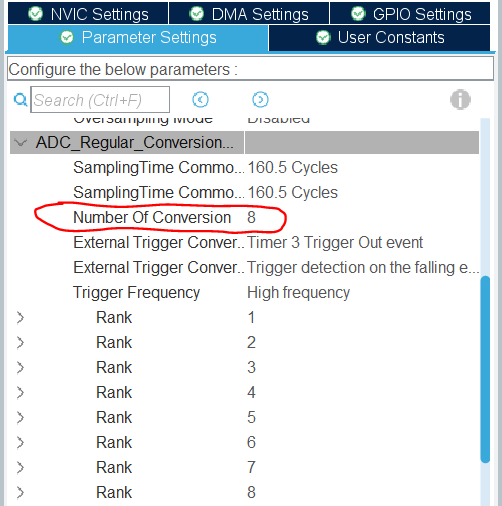

I have to use 9 ADC channels using scan conversion mode.
I can't set Number Of Conversion field more than 8.
The ADC used pins are set as ADC inputs.
If somebody has an answer please help me with this thing.

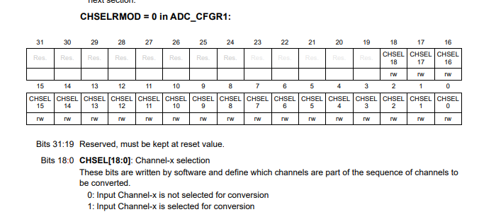

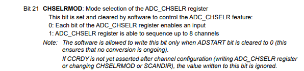

‎2023-04-03 3:11 AM
from
set
but you want > 8 ch , so :
ok ?

‎2023-04-03 3:11 AM
from
set
ok ?
