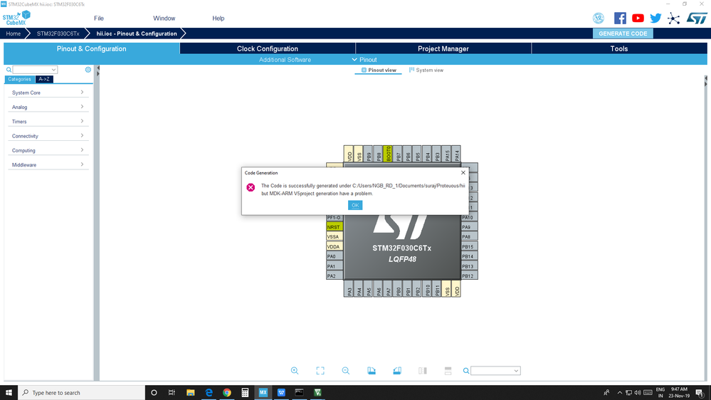

i have problem ,after generationg code ,msg is showing that ,"the code is sucefully generator under the c:/....,but MDK-ARM V5 project generation have a problem.

Please can any one help me,,,,its important for me...my project is pending due to this problem.Thanks in advanced.0690X00000AsNUWQA3.png

Sorry for late respose, older version working perfectly. please see whats problem with new version .Thank you.

Hello!
I just got a similar error.
After several hours of experimentation (the day before I installed a significant amount of software related to LoRaWAN and not directly interacting with development software), I found out that the error occurs stably after installing Java SE 13.0.2.
After uninstalling Java SE 13.0.2 (Java SE 11.0.6 remains installed), the error disappears and the development software works fine.
Pay attention to this both when upgrading STM32CubeMX and when installing new versions of Java.

​Hello @MLiak.1​ ,
Yes Problem appears with the java 13.
Issue will be fixed in a next release , we are sorry for any inconvenience this may have caused.

INFO : max version supported is java 11.
