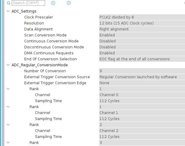

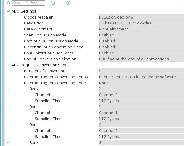

Hello!
I use CubeMx 5.0.1, my project based on STM32F413 cpu and was migrated from previous version of Cube. I need to set ADC1 to perform multiple regular conversions. This is what Cube shows me:
You can see two entries marked Rank1. How can it be?

You can see that Rank 1 is configured twice. So, I suppose that only channel 0 will be converted.
Previous Cube version functioned the same way, so I suspected a bug and updated my Cube, but new version yields the same result.
Is it a bug in Cube or I'm doing something wrong?
Thanks!
Michael
Best answer by micklecat
Solved. I had to deactivate ADC completely in Cube, then start assigning channels from scratch.
