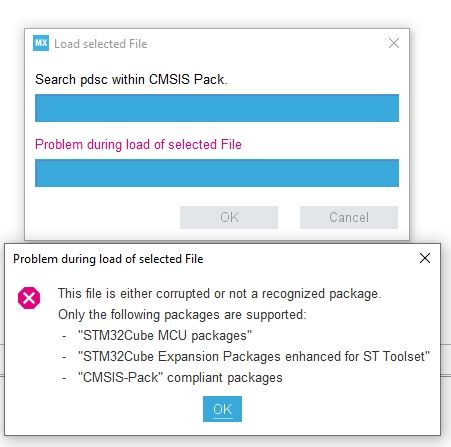

April 25, 2022
Hi @FCOST.1​,
Did you make any progress with installing the x-cube-eeprom extension package?
I just installed the latest STM32 CubeMX Version 6.5.0, and when I try to install en.x-cube-eeprom_v4.0.0.zip via "Help -> Manage embedded software packages -> From Local ..." I get the attached error message.
I second your comment - it would be really helpful to know at least how to "manually" install (by copying folders & files) the en.x-cube-eeprom_v4.0.0 package since the "automatic" way respectively the package is somehow broken.
Just my two cents.
Peter BENSCH
April 25, 2022
@Martin M.​ This is the same question as has already been answered, please see this link.
I hope that answers your question as well?
Regards
/Peter
Martin M.
April 25, 2022
@Peter BENSCH​
Thanks for clarifying this issue, Peter!
The whole topic is a bit confusing as the package name "X-CUBE-EEPROM" and the manual installation option give the impression that it should be compatible with STM32CubeMX (like many other X-CUBE packages).
I was also wondering why the X-CUBE-EEPROM package doesn't show up in the CubeMX package manager, but now that's clear too.
However, I will find my way to make use of the emulated EEPROM functions by cherry-picking them from the package and adding them to my project.
Thanks.
