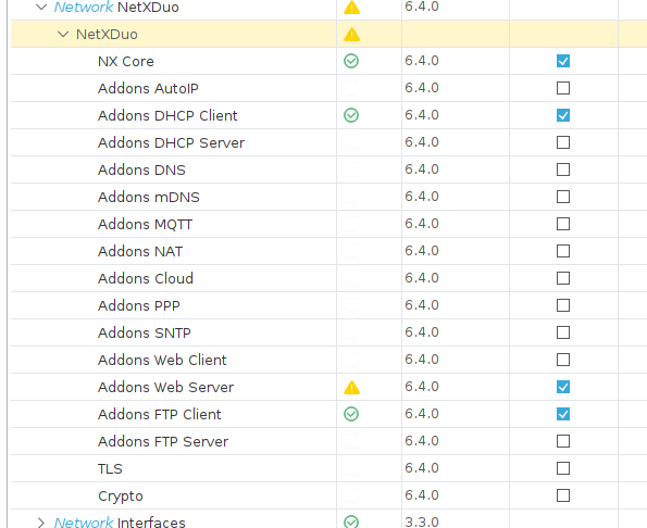

i am using netxduo in one of my projects and need to use TFTP addon. I am wondering how to activate / install this addon in software selection. There are also some other addons missing.
How is it supposed to install and use such missing addons?

According to the dev team, CubeMx doesn't support TFTP and there is no plan to support it for the moment. You can use FTP instead.

yes.
Compared to the available addons on NETXDUO GitHub, there are less addons available in CubeMX, as you can see in the screenshot:
by now, i only need the TFTP.
thank you
I'm asking that question internally (ticket number 200261). I'll get back to you as soon as I have an answer/feedback.
Sorry for any inconvenience.
