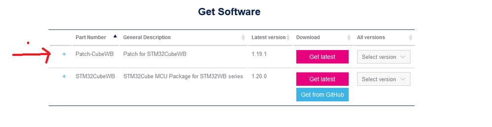

I found the link to download STM32CubeWB
https://www.st.com/en/embedded-software/stm32cubewb.html
Now reading the manual to see how to add it?
Quick question do need to install the Patch for STM32CubeWB?
2024-08-13 7:46 AM
No need to install the patch. You just have to download the Version 1.20.0 and add it to CubeMX as mentioned on the User manual that I've shared with you.
If you are going to use another MCU, you will need to add his Cube Package (an STM32Cubexx for each STM32xx MCU).
If your original question is answered, please select the answer as best answer. You can always start a new post if you have any new Question.
we use this method to give each request the best visibility for our community users.
