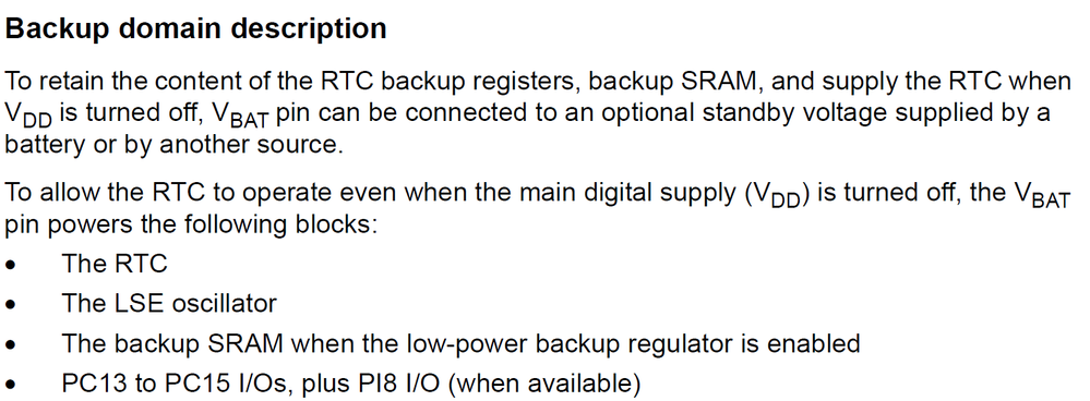

Backup registers are in SRAM and are erased when power is lost. VBAT supplies power to them, so the typical way to retain them is to attach a battery to VBAT to keep it powered when your main source of power is gone.
From the RM:
1 REPLY 1
From the RM:
