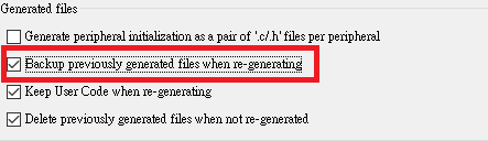

Hi, andreas,
Normally, in the generated files, you will see something like this:
/* USER CODE BEGIN Init */
/* USER CODE END Init */
you may insert your codes in between these lines.
Next time when you modify your ioc project and regenerates it, these parts would be kept.
If you put some codes somewhere not between these lines, the generated codes would probably erase your codes.
Also enable the backup functionality in the project settings
Good luck!
