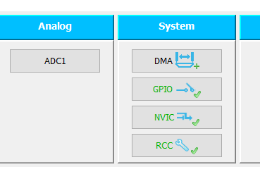

I am trying to set up an ADC channel on a specific pin on the STM32F207ZETx; PA0 (pin 34) and I have come across a pretty "big" problem.
When I set the pin and go to configure the pin, the "ADC1" button does not respond to a click and doesn't "look" like it usually does. I have attempted this on different STM32F2 MCUs with the same result. Everything seems fine with the F1 and F3 chips when I set them up.
There is no icon, so to speak, on the button and nothing happens when I click it. To make things worse, once a project is saved like this it cannot be re-opened - it becomes corrupt.
I am using version 4.26.1

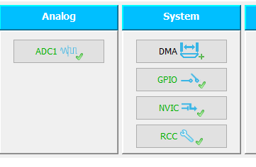

For reference this is what it is supposed to look like when there are no issues:

Dear @alex_embedded​ ,
Many thanks for your feedback! This is the convenient place to report any potential bug you encounter.
I have reproduced the issue you're seeing and I will highlight it internally for further investigation.

Hi @alex_embedded​ ,
Just note that the new release of the STM32CubeMX tool (V4.27.0) is now available under ST website.

Hi All,
Just a quick update,
CubeMX did not find the new version but I did download it and install it manually. My project has been migrated to the new version and I can confirm that the ADC setup appears to be working!
