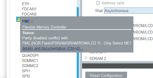

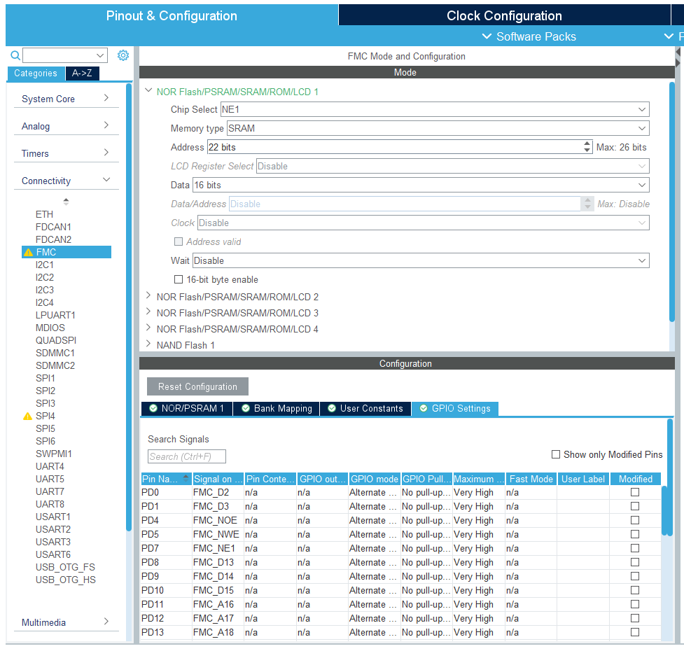

Dear ST Community,
I need to use an SRAM with the STM32H743AII6 MCU. When I try to configure the project on CubeMX, a warning appears next to the FMC line. I feel like I should fix this before going further with the configuration.
I am curious why I am getting this warning even when FMC is the only peripheral that was already configured. Has anybody experienced this before? Are there any suggestions to resolve this?
Here is a summary as background information:
  • The warning text says "Partly disabled conflict with FMC Chip Select NE1".
  • Warning stays even if I use NE 2/3/4.
  • The package is UFBGA169, and NE1 pin is available on that specific pinout.
  • CubeMX version is 6.11.0 but the issue was present with earlier versions as well.
  • A screenshot is attached below.
Thanks,
JD

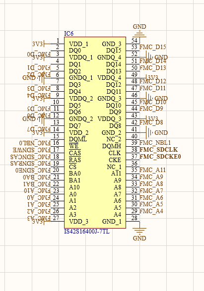

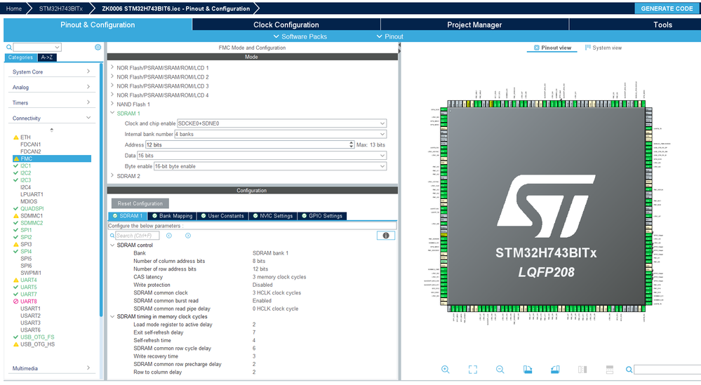

MNapi
Senior III
see my configuration I have the same chip connected to IS42S16400J-7TL (SDRAM 64 Mbit )

SofLit
What message is showing when you pass the mouse cursor on the warning icon?

jd2
Hi SofLit,
Here is the message:
Best,
JD
I think you can go ahead and ignore that warning.
If you notice any missing in the FMC config in the generated code, you can notify us.

MNapi
Senior III
jd2
Dear MNapi and SofLit,
Thank you for your answers, you've been so helpful. I'll proceed with my design.
Best,
JD
if you want to use the same memory chip
you need to initialize it:
