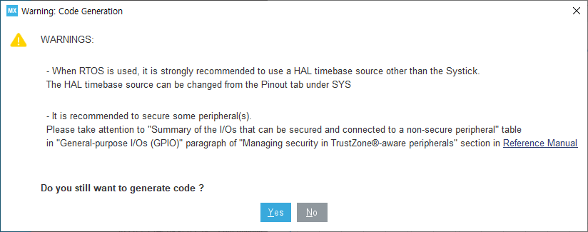

I want to generation code with FreeRTOS in Trustzone at STM32L562ZET6Q.

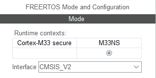

I want to use FreeRTOS in Non-Secure Zone.
So, I enabled FreeRTOS in Middleware division.

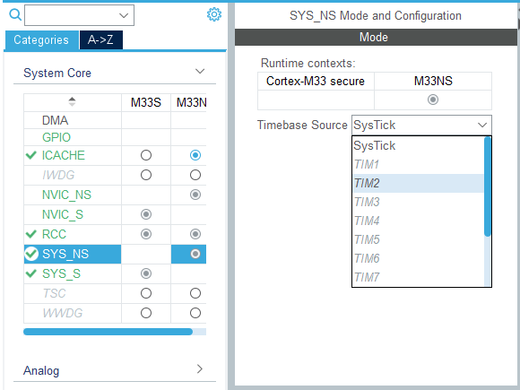

0693W00000WKMW2QAP.pngAnd, I want to change about Timebase Source in SYS_NS.
0693W00000WKMVnQAP.pngBut, all timers are disabled(inActive) except SysTick.
0693W00000WKMY3QAP.pngSo, there occur warning message about SysTick when run code generation.

STM32CubeL5 : v1.5.0
Best regards.

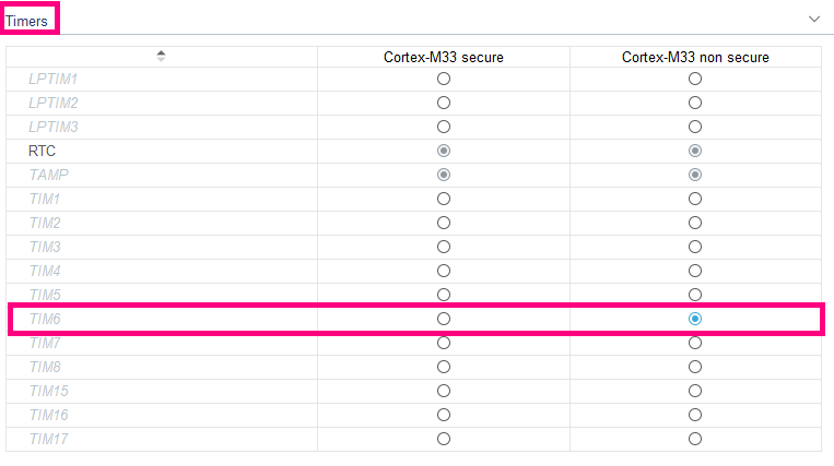

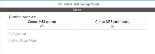

Hello @JongOk Baek​,
You can change the Timebase source in SYS_NS by enabling the dedicated timer as shown in the below figures.
 I advise you to get inspired from the available freeRTOS examples in the STM32CubeL5 MCU package.
