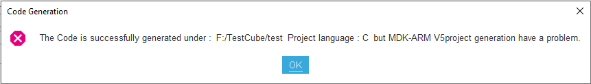

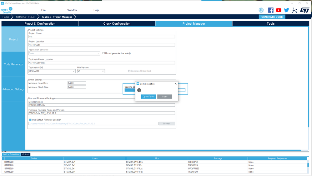

When I create an empty project and press generate, the generation fails. First I get a empty dialog screen:
0693W000007Du3eQAC.pngAnd then an error:
0693W000007Du4NQAS.pngIs this a bug?

In fact, The minimum JRE version required by CubeMX is 1.8_45 and the version 11 is supported. For the versions 7, 9, 10, 12 and upper are not supported (which is your case).
So you need to change your JRE version first, then problem will disappear.

The Amazon JRE v11 seems to work. Java is dead with all these different versions, please port the application to a proper language.
