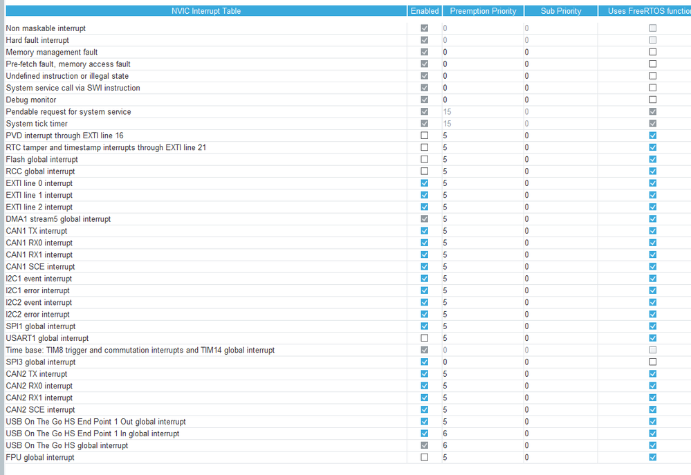

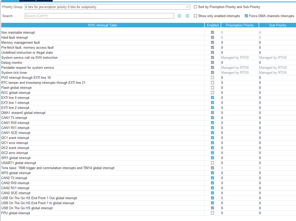

Upgraded project of F446. Then he did not leave. I put a breakpoint in StartDefaultTask. After starting , he never made it to her. I thought that these childhood diseases of STM32CubeMX have long been overcome. There were similar problems with the initial versions. What struck me was that the priorities of the interrupts are 0 (in the previous version it was 5). I went back to STM32CubeMX 5.6.1. I will wait for new release.
this is at CubeMX 6.0
