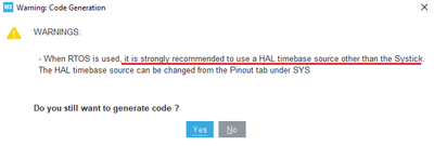

./AZURE_RTOS/App/app_azure_rtos.c:53:14: error: expected ';' before 'static' 53 | __ALIGN_BEGIN static UCHAR tx_byte_pool_buffer[TX_APP_MEM_POOL_SIZE] __ALIGN_END; | ^~~~~~~ | ; ../AZURE_RTOS/App/app_azure_rtos.c:53:70: error: expected '=', ',', ';', 'asm' or '__attribute__' before '__ALIGN_END' 53 | __ALIGN_BEGIN static UCHAR tx_byte_pool_buffer[TX_APP_MEM_POOL_SIZE] __ALIGN_END; | ^~~~~~~~~~~ In file included from ../Core/Inc/app_threadx.h:29, from ../AZURE_RTOS/App/app_azure_rtos.h:31, from ../AZURE_RTOS/App/app_azure_rtos.c:23: ../AZURE_RTOS/App/app_azure_rtos.c: In function 'tx_application_define': ../AZURE_RTOS/App/app_azure_rtos.c:81:68: error: 'tx_byte_pool_buffer' undeclared (first use in this function); did you mean 'tx_byte_pool_create'? 81 | if (tx_byte_pool_create(&tx_app_byte_pool, "Tx App memory pool", tx_byte_pool_buffer, TX_APP_MEM_POOL_SIZE) != TX_SUCCESS) | ^~~~~~~~~~~~~~~~~~~ ../Middlewares/ST/threadx/common/inc/tx_api.h:1342:84: note: in definition of macro 'tx_byte_pool_create' 1342 | #define tx_byte_pool_create(p,n,s,l) _txe_byte_pool_create((p),(n),(s),(l),(sizeof(TX_BYTE_POOL))) | ^ ../AZURE_RTOS/App/app_azure_rtos.c:81:68: note: each undeclared identifier is reported only once for each function it appears in 81 | if (tx_byte_pool_create(&tx_app_byte_pool, "Tx App memory pool", tx_byte_pool_buffer, TX_APP_MEM_POOL_SIZE) != TX_SUCCESS) | ^~~~~~~~~~~~~~~~~~~ ../Middlewares/ST/threadx/common/inc/tx_api.h:1342:84: note: in definition of macro 'tx_byte_pool_create' 1342 | #define tx_byte_pool_create(p,n,s,l) _txe_byte_pool_create((p),(n),(s),(l),(sizeof(TX_BYTE_POOL))) | ^` make: *** [AZURE_RTOS/App/subdir.mk:19: AZURE_RTOS/App/app_azure_rtos.o]
Error 1 make: *** Waiting for unfinished jobs.... "make -j64 all" terminated with exit code 2. Build might be incomplete.
mƎALLEm
Did you get this warning message? and clicked "Yes"?
You need to change HAL time base source othr than Systick Ex: TIM7.
I've attached a fixed .ioc file.

mƎALLEm

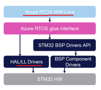

Hi
1. Then, can you not use LL ?
2. Must we use another timer (not a systick)?
Or both?
According to the following figure from this link no restriction to use LL:
When using RTOS you need to select another timer for the driver and systick is reserved for RTOS timebase.
