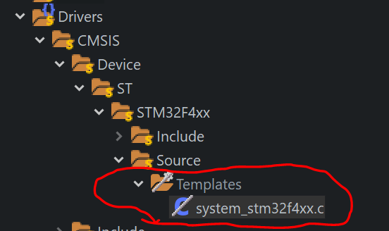

After upgrading the IDE to version 1.5.1 within the eclipse IDE, the CubeMX built in tool auto generates this file.
0693W000008xsSnQAI.png This conflicts with the one in src (same function is defined in both places). I had to temporarily exclude the folder from build for it to compile properly. My collogues who also have the same version of the software do not have this issue.

Hello @Ahmed​
Thanks for your feedback,
Could you please check with the latest CubeMX and IDE versions (6.2.0 and 1.6.0) ?
If problem still occurs, please share your ioc file to check it.
Thanks, Khouloud
Ahmed
AhmedAuthor
March 25, 2021
I cannot share the .ico against the company rules. I'll try to recreate the problem using a fresh .ico file.
I have tried latest CubeMX and IDE versions (6.2.0 and 1.6.0) problem does not go away.
Khouloud ZEMMELI
March 25, 2021
Hi again @Ahmed​ ,
You can send me your project in private message if you don't want to share it in public, otherwise, I'll be waiting for your feedback :)
Khouloud
