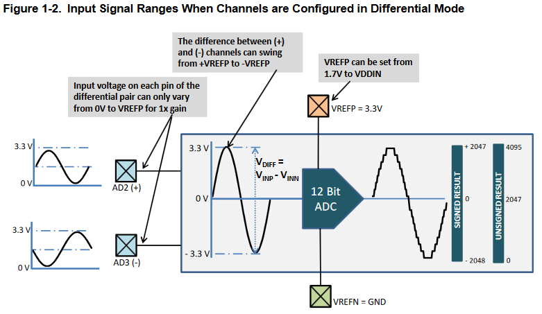

In STM32CubeMx H7(v1.5.0) the example of ADC_DifferentialMode for NUCLEO-H743ZI is showing that we can measure difference voltage range of 6V6 in this mode and readme,txt file is also clearly telling us that we can vary the input voltage from -3V3 to +3V3 at both input VIN+ (PB.01) and VIN-(PB.00) of op-amp. But doing this the output voltage swing of op-amp will be +6V6 to -6V6 which are clearly out of range values.
Can someone clarify that. Even though the datasheet tells us we cannot connect a negative voltage at analog input. Isn't this should be like that

Even though the microchip ADC datasheet for cortex M-7 (http://ww1.microchip.com/downloads/en/DeviceDoc/90003182A.pdf) is also showing that we can measure difference in voltage up to 6V6 peak to peak but its showing that input values at both inputs with in the range of 0V to 3V3.

Look at the first waveform in Figure 1-2. Absolute voltage range at AD2/3 is 0...3.3 Volt only. Nowhere there is a swing +6V6 to -6V6 . In side the chip, there is no OP, only sampling capacitors.

Differential mode in the STM32 context means the difference between two ADC inputs.
This means:
  • you need two ADC input channels for one "differential input"
  • neither of this "differential inputs" must ever have a voltage potential below GND/AGND

Both inputs are within 0-3.3V, but differential can be 0-3.3=-3.3V to 3.3-0=3.3V.

  • Each ADC input pin (independent off + or - channel) could convert from VRef- to VRef+.
  • VRef- must be connected to VssA (maybe filtered)
  • VssA must be connected to Vss (maybe filtered)
  • => there should be a common ground from your measure source to the µC or you could damage the µC
You could have 6.6 V differential peak to peak (based on 3.3 V for REF+) and all is within the datasheet:
First sample (16 Bit):
AIN1+ = REF+
AIN1- = REF-
=> INT16_MAX = 3.3 V
Second sample (16 Bit):
AIN1+ = REF-
AIN1- = REF+
=> INT16_MIN = -3.3 V
