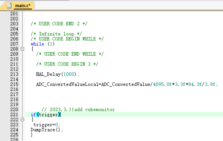

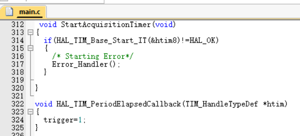

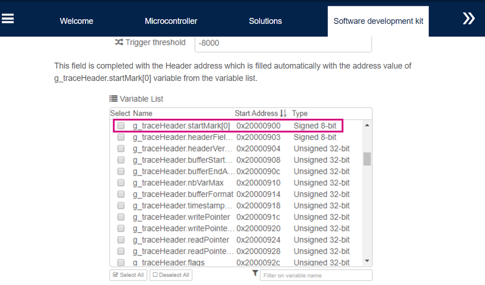

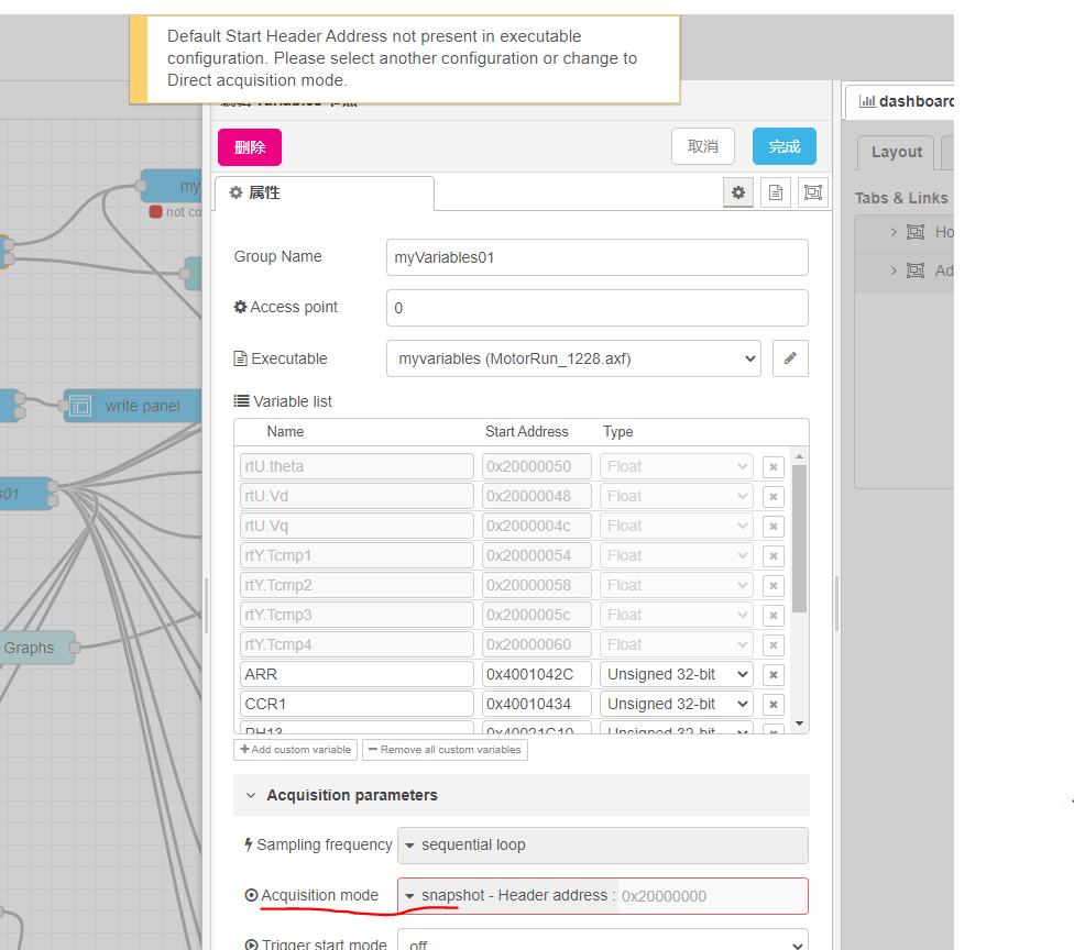

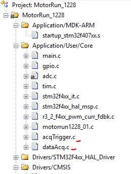

hello everyone,
I switch direct mode to snap mode,and add relevant C and H files.But Acquisition mode can't change snap mode. Variable list can't find "g_traceHeader"
which may be my operation error ?

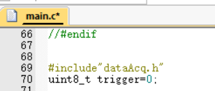

I've seen you've disabled dataAcq.h file, this file is required for snapshot.
Can you please try to include this file and activate USER_TRIGGER option and let us know the status.

Oups I was thinking Python and not C, # is not a comment....
However, can you check USER_TRIGGER option status is activated.
