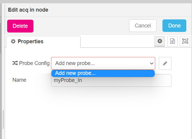

I have a STM32F407G-DISC1 board and I'd like to monitor some values (I/O pin states) using the CubeMonitor. However, when I try to configure the ACQ node no probe is found. I downloaded the latest version of the ST-Link driver and it does show up as a COM port.
Any idea for a solution is welcomed!
AMabi.1
UPDATE: I think it is because I had too many ST-LINK drivers. It was already installed once by the CubeIDE, but not knowing that I tried to install it by hand. I tried the CubeMonitor on another PC with just the CubeIDE and it worked.
