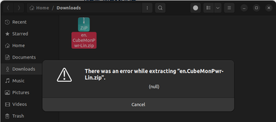

Hey Guys,
I downloaded STM32CubeMonitorPWR software for linux from officail site - link.
After Downloading when i try to unzip the file it shows "There was an error while extracting the file." Can anyone help me with this.

    Peter BENSCH
    Jul 5, 2023 10:02 AM UTC
    The ZIP archive was probably damaged during the download.
    • What is the file size (bytes) of the ZIP?
    • Can you determine the checksum SHA-256?
    Regards
    /Peter
    LR.2
    LR.2Author
    Jul 5, 2023 10:08 AM UTC
    Hi Peter,
    The file size is 60.3 MB and the checksum SHA-256 is
    5e9196eff0da4693a4ec7759c1ae22c740f033aa9c3ab2a424f7b8dff07989b7
    File Name: en.CubeMonPwr-Lin.zip
    Regards,
    Lakshmanan
    Peter BENSCH
    Peter BENSCHBest answer
    Jul 5, 2023 10:22 AM UTC
    Well, 60.3MB is a rounded number, which is why I asked for the file size in bytes, which by the way is 60'292'403 in version 1.2.1. But at least the checksum is already incorrect, correct would be: 9F8E3CAD09F734B13151F3DA5828465879AAB4F8F7E26BA4A1DA17E0A97109E6
    Please repeat the donwload again.
    Regards
    /Peter
    LR.2
    LR.2Author
    Jul 5, 2023 11:27 AM UTC
    Hi Peter,
    Thanks I downloaded again and it worked fine. Also, I checked the checksum its the same as you mentioned. Earlier I tried downloading in different PC's but still the issues existed know I can able to download and extract properly.
    Regards,
    Lakshmanan
