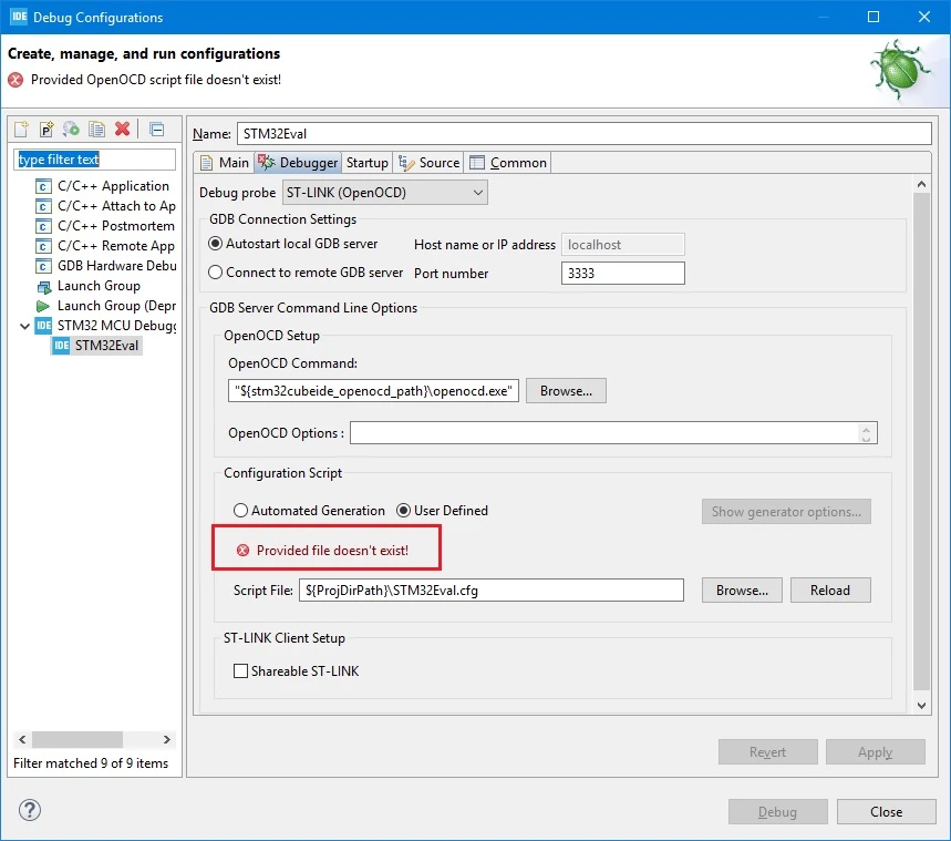

When I specify a user debug script in STM32CubeIDE debug configuration window I get the error "Provided file doesn't exist" even though it's there. Even if I specify the same text as the "Automated Generation" option I get this error.
Is there a workaround ?

Does it work if you "Browse" to it or have the file name/path in quotes like the OpenOCD Command?

Clive,
Thanks for the suggestions. Unfortunately neither worked. I even tried overwriting the auto-generated script with my debug script then making it read-only but it gets overwritten every time debug mode is entered.
This must be a bug. Any idea where I can report this or do you know if ST devs read these posts ?

mattias norlander
August 15, 2019
It is strange. "Browse" button works for us, it i is only typing a path that does not work. I saw that Clive already suggested browsing and that you have tried this without success?
We will try to fix for next release.
dave2012
dave2012Author
August 15, 2019
Mattias,
When I browse to a configuration file, even one generated by STM32CubeIDE, then close and re-open the debug configuration window I see get an error - see attached. There's also an exception popup and the corresponding entry in the erorr log is listed below. Hope that helps.

dave2012
dave2012Author
October 31, 2019
User supplied OpenOCD scripts now work with v1.1.0 - thanks for fixing it
