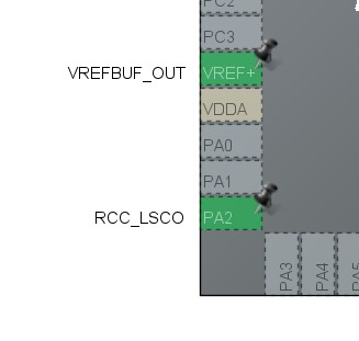

Here is my pinout view where I can choose VREF+ as VREFBUF_OUT :

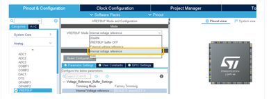

Here is the panel of someone else where VREF BUFF can be configured :

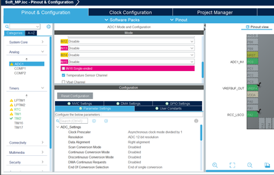

Finally here is mine where I can't configure VREF BUFF :
My question is : the microcontroller i use allows to use VREF BUFF but I can't configure it in STM32CubeMX. Can someone help me on that?

You can find the VREFBUF mode configuration under System Core, SYS, VREFBUF Mode.
