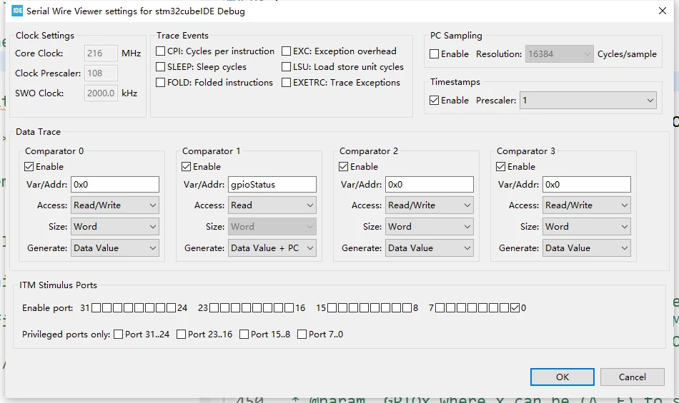

using stm32cubeide to debug stm32f767,it can use swv to trace a variable?
gcaif
this is the swv setting. but I click resume button,the swv data trace timeline graph don`t respone.

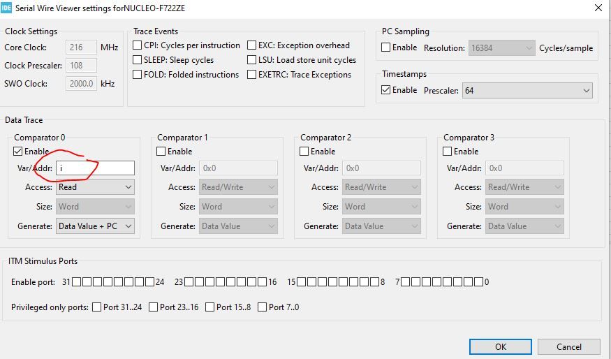

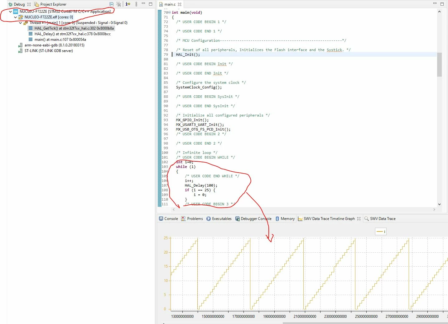

Here is my SWV usage on a F7 board. Sounds working like a charm.
Common pitfall is bad core clock frequency setting.
Then maybe you're trying to track an event which is too fast ? Please note SWO clock is not running same speed than core clock ...

Maybe see https://www.youtube.com/watch?v=4wT9NhlcWP4 first of five videos addressing advanced Debug especially SWV stuff.
