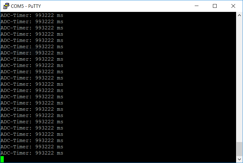

I'm working with the Nucleo-G474RE Board. With the STM32CubeIDE I set up FreeRTOS and assign TIM6 as Timebase Source (as recomended by the IDE). I create a basic Thread to test a basic scoped timer I want to use for timing measurement. The ScopedTimer Class is supposed to use TIM2 for it's measurement. TIM2s Prescaler is set to 170 and its Counter Period is set to 0xffffffff (max value for 32bit).

The Console Output:0693W000003BaODQA0.png
So It's working perfectly fine so far.

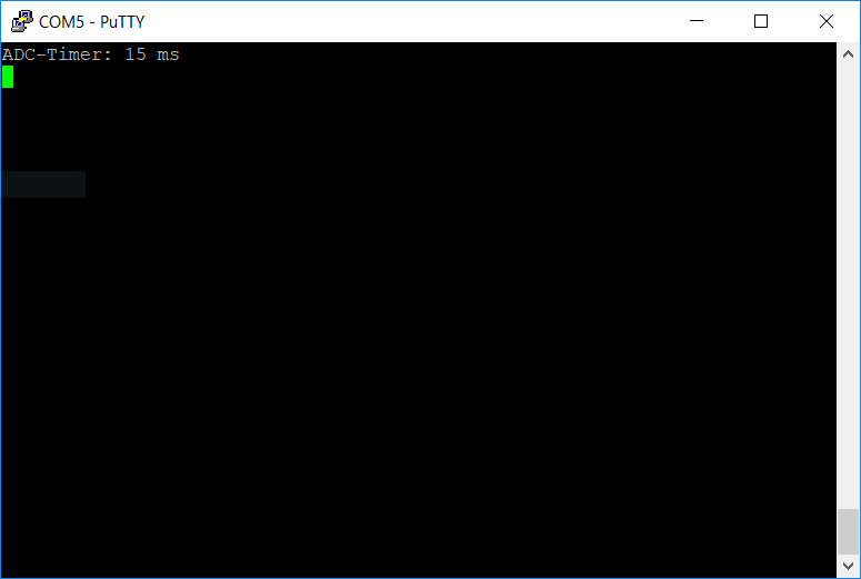

Now I read analog Values from ADC1 inside the Thread and store them in a history array for future useage. This is where the code brakes.

Now the Task-Code looks like this:

And the output on the console looks like this:
The Deconstructor of my ScopedTimer Class gets called once. After that the task never gets called again. when I pause the Program to step through it, I end up inside HAL_TIM_IRQHandler for TIM6 (Timebase Timer) and never return to my Thread.
Does anyone know what the problem is? If I use HAL_GetTick() inside my ScopedTimer instead of TIM2 it works perfectly fine, but I need the µs resolution since ms would display 0ms.

JHöfl.1
The console output says ms but it's acutally µs. I forgot to change it after testing with HAL_GetTick() insted of m_timerHandler->Instance->CNT.
