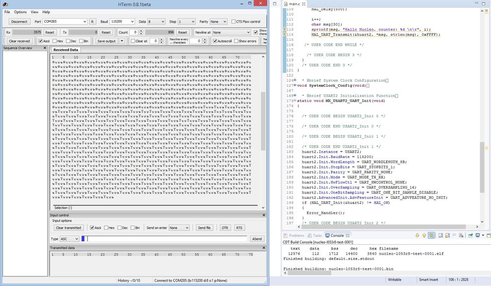

As you can see in the picture below, there is something received periodically. However I'm not able anymore to set a baudrate (at HTerm) which decodes the transmitted text. I assume that the baudrate, set in USART2, is totally mismatched and anything else than 115200. Unfortunately, in this location I do not have an oscilloscope available to figure out what is reall transmitted there.

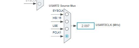

I have checke the USART clock, which is about 2 MHz. Unfortunately I'm not aware if that's the correct value. As what I found here,  the clock should be correct.
Another strange observation: I'm transmitting around 28..30 Bytes. Each loop, HTerm receives exactly 29 Bytes, but can't detect anymore. Without an oscilloscope, I would guess the USART signal could be somehow inverted???

You might have better luck if your UART clock is an even multiple (of at least 16x) of the rate you want to output. Without this, you introduce some error, which the receiver may or may not be okay with.

To exclude any software issues, I tried to send a static text and surprise - it transmitts correct!
    HAL_UART_Transmit(&huart2, "Test0123456789", 14, 0xFFFF);
So, there must be a compiler issue, handling the pointers to the variable pData {HAL_UART_Transmit(huart, pData, Size, Timeout)} when typecasting probably is not correctly defined. Handling of this issues seems to have changed with the uptade (new version of compiler).
What I saw to be transmitted, was the correct amount of bytes (as mentioned abobe), but some randomly picked data from elswhere in the memory!
