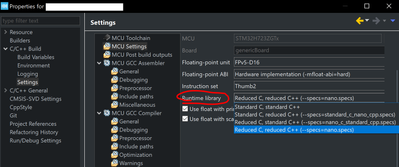

In project settings -> MCU settings, you can choose the C++ library.
Although <list> compiles fine for me with nano, so not sure what would be different.

Reduced C, standard C++ switch, seems to have taken 190 'unfixable' errors down to 35 'fixable' ones
