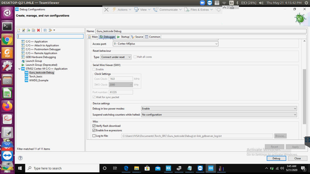

Unable to enable the serial wire viewer option in stm32cubeide?
MR.2
0693W000001cet6QAA.pngThe serial wire viewer option is disabled, i can't enable the serial wire viewer option in the stm32cubeide. Can you give some suggestions ?
2 REPLIES 2
Pavel A.
Evangelist III
Cortex M0 does not support serial wire output.
-- pa
MR.2
