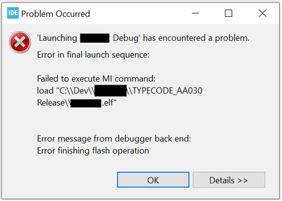

TomC1
Further info, I also get this dialog when the debug fails:
Andrew Neil
What microcontroller, and on what board?
Are you using 'Connect Under Reset' ?
The "ST-LINK error (DEV_UNKNOWN_MCU_TARGET)" would seem to be key:
https://community.st.com/t5/forums/searchpage/tab/message?q=ST-LINK%20error%20%2BDEV_UNKNOWN_MCU_TARGET&noSynonym=false&collapse_discussion=true
It's a known issue with STM32CubeIDE v1.15. Already escalated internally to be fixed asap.
