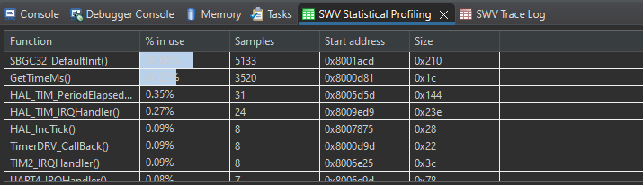

See the image below:
As you can see - the cells that has some higher percentage are almost unreadable. It seems to be using the same colors for the 'normal' eclipse debugging table-like features such as Variables, Live Expressions, Expressions, etc.

Using Darkest Dark as suggested here sort-of solves the problem.
The text is indeed readable but the highlighted area to represent the percentage is not visible unless selecting the cell. Doesn't really matter though.
