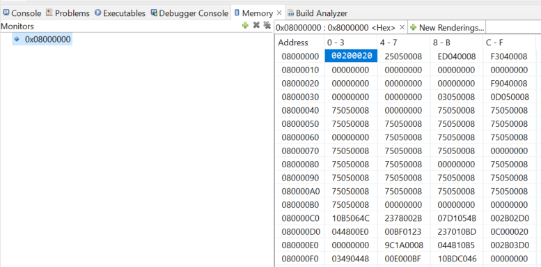

I've used Keil for the last year - and they have a feature where I can view the flash memory while debugging (and even change it)
I can't seem to find that with CubeIDE. Is there a way to see flash memory? I want to read/write and confirm it's there, etc.

Window-> Show view-> Memory and Window-> Show view-> Memory Browser

In order to debug flash memory you can add your flash address in the memory browser window.
This screen shot may help you.
