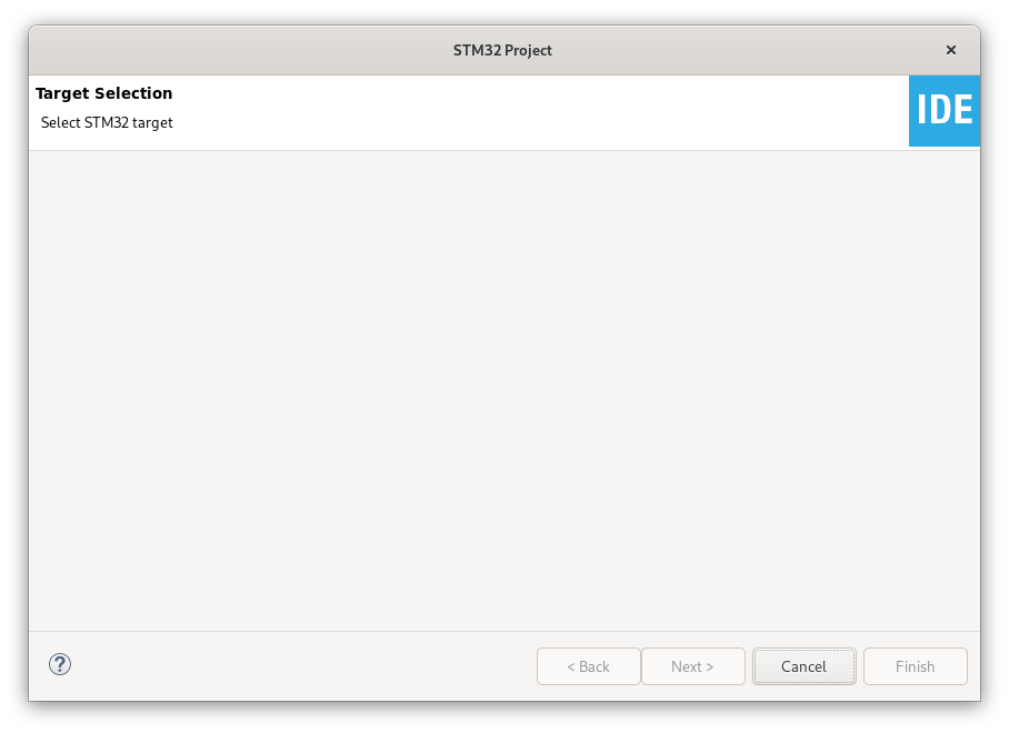

I just installed 1.2.0 on Linux (ArchLinux). When I run Start new STM32 project, I get an empty target Window:

Are you relying on Wayland as window system ?. According STM32CubeIDE release notes such is not supported. Rely on Xorg instead.

OK I see. It now works with a Gnome session on Xorg.
Thanks a lot.

Just notice such is not a STM32CubeIDE itself issue but some well known Eclipse project components limitation STM32CubeIDE may rely on.
