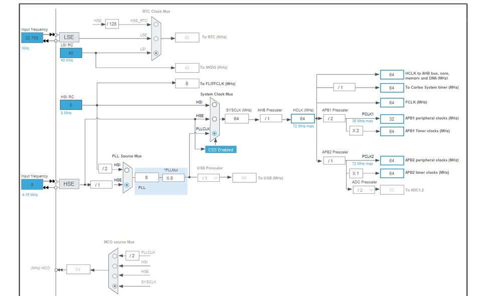

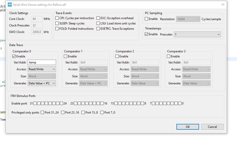

Serial wire viewer is not showing since STM32CubeIDE version 1.0.1. It has worked before in version 1.0.0.
I'm trying to use it with a STM32F103RBT6 but also tried it with a Nucleo F103RB.
The live Expressions work perfectly fine, but not the SWV it just does nothing (no I havent forgot to press the record button).

Don't you have to enable some ports?​
‎2019-07-05 12:12 AM
As far as I know only CubeMX changed going from 1.0.0 to 1.0.1. Which debug probe are you using? Show as the Debugger configuration.
‎2019-07-13 1:05 PM
I've fixed it, it was not a software problem. I just had a bad connection on the SWO pin.
