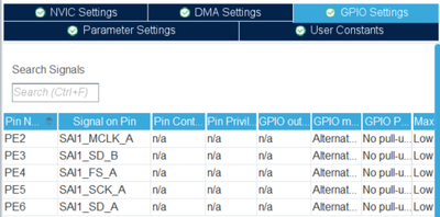

GPIO Settings :

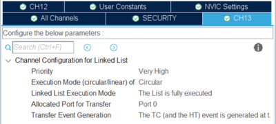

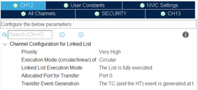

We set GPDMA1 channel12 and channel13 for SAI

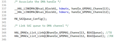

In main() :

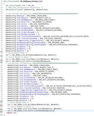

MX_SAIQueue_Config():
