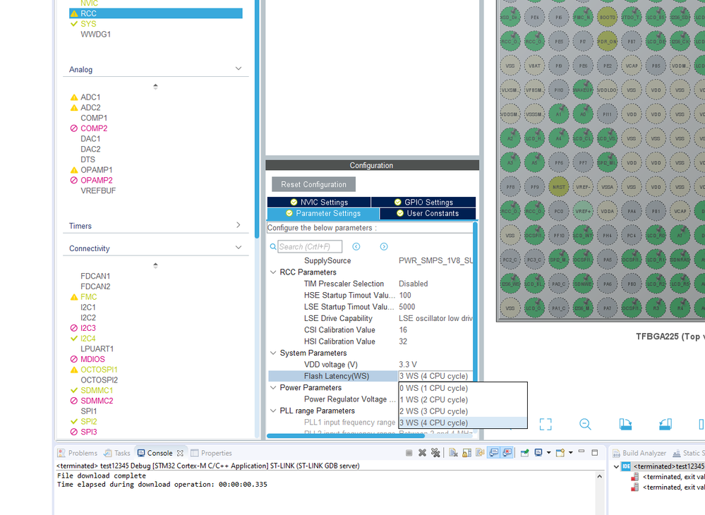

‎2020-06-18 6:57 AM
So, The flash latency is the problem. Al of the example and the default projects generated by CubeIDE1.3 use an incorrect value for the flash latency.
FLASH_LATENCY_7 is the correct value. Verified on the board I have. I noticed that the CubeIDE doesn't even have a option for it.
I'll post a link in the CubeIDE section. Maybe the developers can fix this. It is pretty difficult if you are starting fresh with the tools and the default configuration does not work.

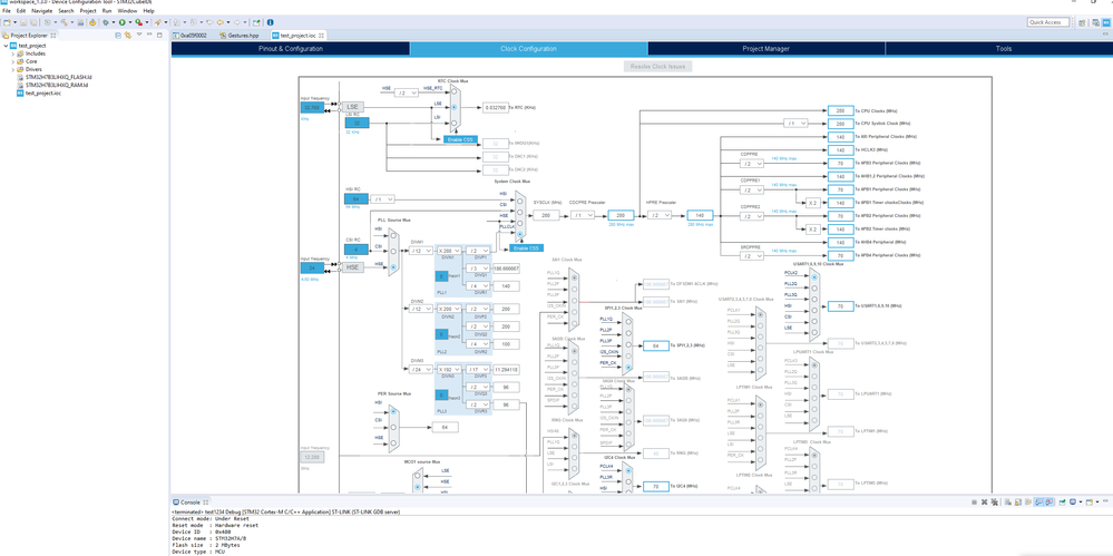

‎2020-07-15 9:17 AM
The attached project was generated with Cube IDE1.3.0. with V1.7 of the STM32H7 support package
1.3.1 is not publicly available. Please install the same version 1.3.0 and you will see the issue.
All of the examples in that version use 280Mhz Clock with a flash latency of 4. The configuration tool doesn't even let you select a flash latency greater than 4.
You will also see that all the examples under:
STM32Cube\Repository\STM32Cube_FW_H7_V1.7.0\Projects\STM32H7B3I-DK
Have incorrect flash latency settings and use 280MHz, not 140MHz.

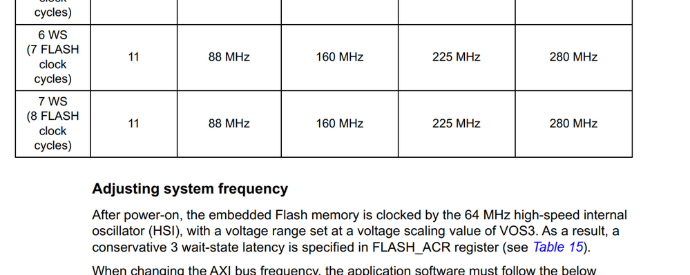

‎2020-07-16 4:03 AM
Hi @EHugh.1​ ,
I checked that the difference between what I was doing and your project is that I am setting the input to AXI peripheral clock to 280 MHz, so the Flash_Latency is updated correctly.
In your case, you set HPRE prescaler to /2 , which provides the value of 140 MHz as input for AXI peripheral clock.
This is correct compared to the content of the table "FLASH recommended number of wait states and programming delay" as we speak about "AXI Interface clock frequency v.s. VCORE range". But it is strange why it crashes for you.
Regarding the examples of STM32CubeH7 package: I took as example STM32Cube_FW_H7_V1.7.0\Projects\STM32H7B3I-DK\Examples\ADC\ADC_DualModeInterleaved. Flash latency is set to 6 there.
-Amel
‎2020-07-16 7:41 AM
Hi @EHugh.1​ again,
I think that I found the root cause of the weird behavior you see.
In generated code, voltage scale is configured to VOS2: __HAL_PWR_VOLTAGESCALING_CONFIG(PWR_REGULATOR_VOLTAGE_SCALE2)
It has to be: __HAL_PWR_VOLTAGESCALING_CONFIG(PWR_REGULATOR_VOLTAGE_SCALE1).
Referring to the table "FLASH recommended number of wait states and programming delay", with 3WS, we need to use VOS1 or VOS0.
I'll report this error to our STM32CubeMX team.
-Amel
