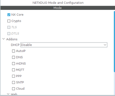

    Now on H563 you have Azure RTOS , with can have FAT , sd-card, USB and network...
    But if want freertos, ...tcp/ip - dont know, maybe look here:
    https://github.com/FreeRTOS/FreeRTOS-Plus-TCP
    https://www.freertos.org/FreeRTOS-Plus/FreeRTOS_Plus_TCP/index.html
