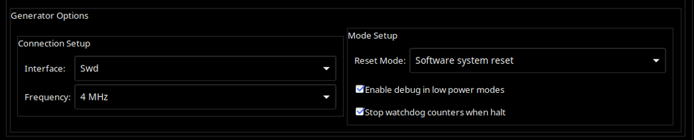

    Visitor II
    August 16, 2024
    Hi all,
    This is my first project i have been working on,i installed stm32cube ide for first time.
     board:STM32H563ZIT6
    I am have some  error while debugging.I want to debug the software.I don't have hardware.How do i debug it.
    when iam trying to do,it is showing me error like this:
    Error in final launch sequence:
    Failed to execute MI command:
    target remote 127.0.0.1:8500
    Error message from debugger back end:
    127.0.0.1:8500: Connection timed out.
    My debugger settings are like this:
    Please give me solution for this error
