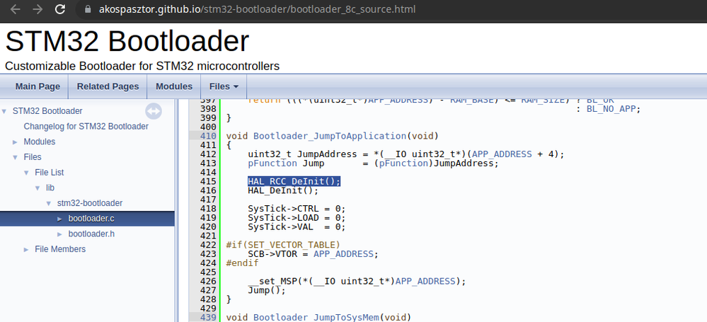

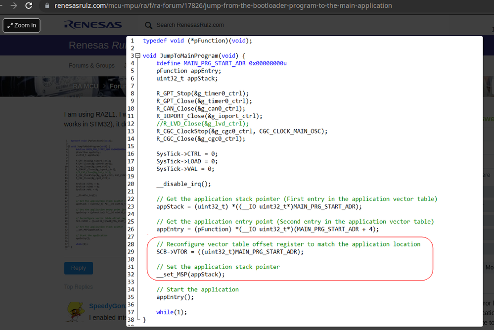

I found (Google found) some references that worked
Google found this one: "when I run the below code block (that works in STM32)"
The code that worked:
uint32_t JumpAddress;
typedef void (*pFunction)(void);
pFunction Jump_To_Application;
#define APPLICATION_ADDRESS (uint32_t)0x08008000
HAL_RCC_DeInit();
JumpAddress = *(__IO uint32_t*) (APPLICATION_ADDRESS + 4);
Jump_To_Application = (pFunction) JumpAddress;
SCB->VTOR = APPLICATION_ADDRESS;
__set_MSP(*(__IO uint32_t*) (APPLICATION_ADDRESS ));
Jump_To_Application();

The instruction that resolved was this:
