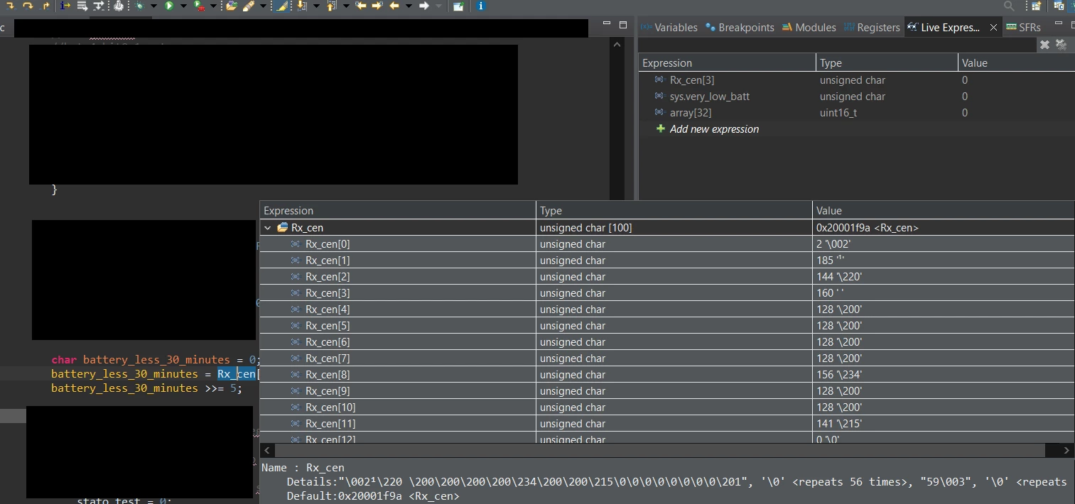

STM32CubeIDE 1.18.0 live expressions stopped working completely
Before the STM32CubeIDE had serious issues with the live expressions during debug, with variables showing random values and signs when they were unsigned (the issues are various years old now https://community.st.com/t5/stm32cubeide-mcus/stm32cubeide-1-18-0-released/m-p/778624#M34678)
After updating to STM32CubeIDE Version: 1.18.0 Build: 24413_20250227_1633 (UTC) the live expressions completely broke
All the variables now show 0 and they won't vary
As you can see from the screenshot, hovering while on breakpoint shows the correct value. On the top right, all the values are 0 in the live expressions tab

The issue seemed to be the GDB server.
Switching to OpenOCD has made the live viewer during debug work correctly
THIS IS NOT THE SOLUTION, CHECK LATEST POST FOR WORKAROUND https://community.st.com/t5/stm32cubeide-mcus/stm32cubeide-1-18-0-live-expressions-stopped-working-completely/m-p/834696/highlight/true#M38371

I'm using Windows 10 22H2, 10.0.19045 Build 19045 on the STM32F091VB
Mar 14, 2025 9:41 AM UTC
Hello @nico23
I am unable to reproduce the issue on my side. Could you try these suggestions below and check if the issue persists?
- Update the firmware version of ST-Link.
- Disable optimization during debugging by compiling with -OO
- Debug with OpenOCD if you are using a GDB server.
