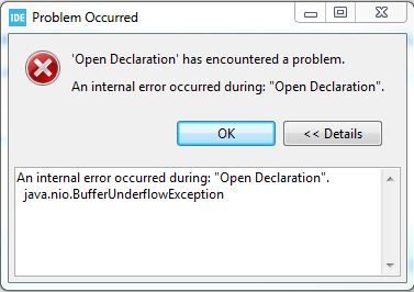

I have an issue using STM32Cube IDE.
For some reason today, "ctrl + click" on functions doesn't work anymore, I receive the following error:
An internal error occurred during: "Open Declaration".
java.lang.NullPointerException
I have upgraded the STM32Cube IDE to 1.6.0 with no avail.

Is this for every project or a specific one only?
Can you send me the workspace log located at $workspace/.metadata/log ?
You can pm it to me so I can take a look!

I received the workspace log and these steps seems to work if anyone is facing the same problem:
  1. Close STM32CubeIDE, it can not be left open during this process.
  2. Navigate to your workspace and go to: .metadata\.plugins\org.eclipse.cdt.core
  3. Delete all the .pdom files in that directory
