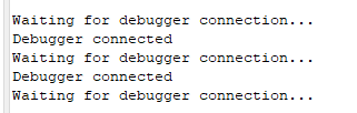

When starts debug my project in CubeIDE Version: 1.16.0 Build: 21983_20240628_1741 (UTC)
 there is always connect from third attempt. Because why and how can I fix it to connect from first attempt?

    This is the expected behavior. During the downloading process, the chip resets twice. When it does, debugger connection is lost and must be reestablished.

    One of those reconnections is due to "Live expressions" being enabled in the "debug" tab of the run configuration.
    What TDK says makes sense, only that even if you disable live expressions (they require a debugger connection) and use "Run..." instead of "Debug..." you still get two connections, when only one would be required to download the program. And anyway, these debugger connections aren't used for downloading, since that's done by separately invoking the Cube32Programmer CLI.
