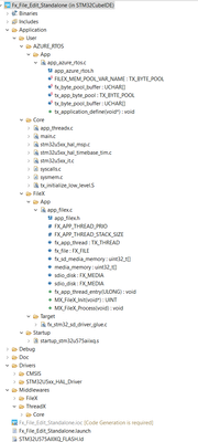

Hi, All
    my file system is working with the eval board of STM32U575I-EV.
    However, run the same software with NUCLEO-U575ZI-Q, file system doesn't work.
    I found that SDIO DETECT is changed to PD5 NUCLEO-U575ZI-Q which was  PF3 on STM32U575I-EV.
    How can I change the SD card pin definiton in IOC? Thanks in advance.

    May 3, 2024
    Hi, NNapi
       Thank you for quick response. I appreciate it very much.
       However, my source code don't has fatfs_patform.h. I also search the source code and cannot find the definiton of SD_DETECT_PIN in my package. please advice.
    Thanks in advance.
    Victor

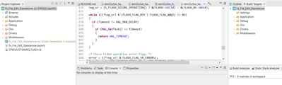

    MNapi
    Senior II
    May 4, 2024
    do search for PF3 , it is defined somewhere and change to PD5
