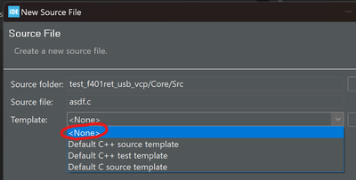

2024-09-29 7:41 PM
Select <None> as a template and the file will be empty when created.

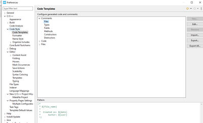

2024-10-02 12:35 AM
i Think your are looking for that?
Here you can edit or delete the text.
