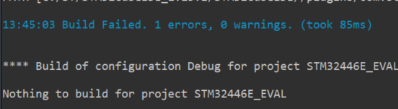

nothing to build for project STM32446E_EVAL
Komal
I have used an example code of CAN loopback using nucleo STM32F446RE
the location is
C:\Users\.........Your User Name.....\STM32Cube\Repository\STM32Cube_FW_F4_V1.27.1\Projects\STM32446E_EVAL\Examples\CAN\CAN_Loopback
Unable to bulid this project and it is showing Nothing to build for project STM32446E_EVAL.
how can I solve this problem

STM32CubeIDE_1.8.0 version
had imported using following steps:
1- Open STM32CubeIDE
2-Click File-->open projects from file system or Archive
3-Import project from the repository "\Repository\STM32Cube_FW_F4_V1.27.1\Projects\STM32446E_EVAL\Examples\CAN\CAN_Loopback\SW4STM32\STM32446E_EVAL"
still it is showing as nothing to build, how can I solve the issue.

opening/ importing a file is not an issue.
the issue is that particular project is not compiling/building
The issue is related to how the project was created or imported. If not done correctly, you will get this error. If you go through the Example Selector, or through the steps @Imen.D outlines above, the issue will likely resolve.

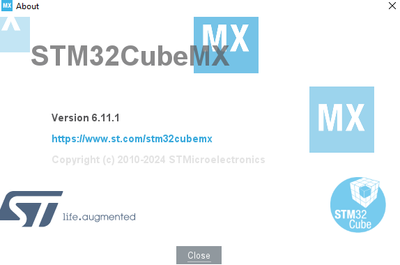

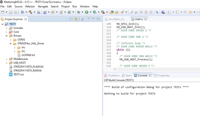

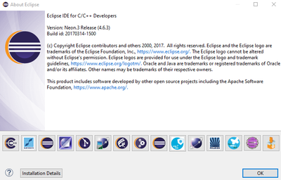

I am using STM32SystemWorkBench with STM32CubeMX.
I am using STM32F411E-Discovery Board (STM32F411VET6U).
I have created a sample project for STM32F411E-Discovery board using STM32CubeMX and imported that project using STM32SystemWorkBench and tried to build it.
As soon as I tried to build it, I am getting below message. I am new to these tools and please let me know incase I am missing something here.
Please refer below snapshots for version details.
Version detail of STM32SystemWorkBench
Version detail of STM32CubeMX
