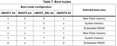

Hi @adityasatyaji , it looks like your FW downloading is success, but FW running is fail, I have some questions:
1. what kind of board are you using? development board of ST or design by yourself?
2. if you have checked your memory address allocation in .icf? maybe you can try a demo code of ST to debugging it by IAR or MDK-Keil.
3. 0x1FFF1FFE if the System memory of MCU, it is boot as below capture, if your boot pin configuration is right?
I am using my own design board and I have not checked the memory allocation as I am using the cube ide .
I will check the boot mode and reassign bits as per datasheet if they are changed. but I have not changed them in code or manually before anywhere so I need to find where they have changed.
